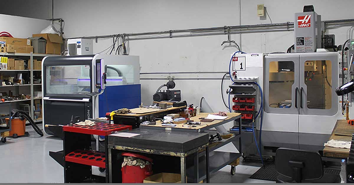

Microsoft’s prototype lab features a diversified lineup of high-speed DATRON machines to complement their more traditional vertical milling centers.

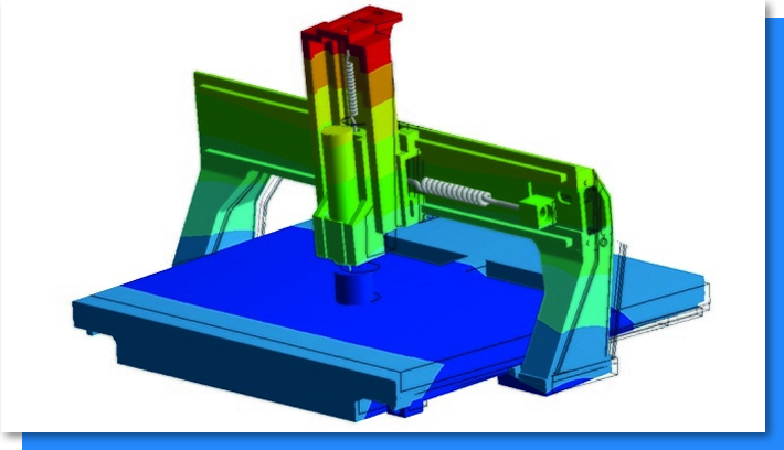

Extensive analysis was performed on the machine’s construction to achieve the most optimal weight/rigidity ratio.
Another key design decision that helps make DATRON milling machines as rigid as possible is the use of polymer concrete for the table/portal casting. In the VMC industry, the use of cast iron for the frame material is common. It makes sense, after all, since cast iron is heavy and relatively thermally stable. However, cast iron has a bit of a disadvantage when it comes to vibration damping. Vibration damping is essentially the material’s ability to absorb vibration energy instead of transferring the oscillation throughout the structure. Polymer concrete (sometimes referred to as epoxy granite) is far better at absorbing vibration than cast iron or other common base materials.
A good analogy for this is to think of a cymbal on a drum set. The reason it’s made from bronze alloys is because of their poor ability to absorb vibrations – thus, they resonate when you hit them. On a drum set, that’s great, but on a CNC machine, it’s terrible. Excessive vibration can lead to poor surface finish, inaccuracy of the part, and diminished lifetime of machine components. To overcome this issue on a traditional VMC using a cast iron frame, you must rely on adding more mass to counteract the vibration. However, with DATRON, the core structure is reinforced with polymer concrete – adding considerable weight while also having superior vibration-damping properties.
