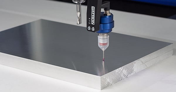

DATRON CNC Integrated Probe Simplifies Workpiece Setup
Photo courtesy of Solid Design Enterprises
Simplify Your Workpiece Setup with DATRON’s Integrated Probe and Smart Control
Why would an integrated probe and smart CNC control make a world of difference to manufacturers and machinists? Because in the real world, material blanks are not perfectly flat or consistently uniform. That makes it challenging to meet tight tolerances if each stock has slight variations from the other. A touch probe solves that problem by taking measurements across the material’s surface and relays that data to the machine, so the control adjusts the milling program to maintain an even depth of cut.
It’s not just flat stock either, a probe can also help with rounded stock. A 3D integrated probe measures the surface, finds reference edges, and creates a height profile. DATRON CNC milling machines are outfitted with a touch probe and dynamic CNC control, so you can stop wasting time and materials on scrapped parts and get accurate, consistent results.

1. Fast Job Setup and Alignment
Workpiece alignment is crucial but having to square a part by manually aligning it with your machine axes is tedious. Manually trying to ensure a part’s exact position and orientation are repeatable for each setup is both tedious and difficult. A touch probe offers a faster and more accurate way to set up and align your workpiece and workholding.
DATRON integrated probes automatically probe for rotation, eliminating the need to square your workholding. A 3D probe enables material or workholding variations in X, Y, and Z to be compensated dynamically. If a part is loaded crooked, the DATRON next control adjusts the program according to the probe’s data. Secondary setups and operations are faster and your parts come out right every time.
2. Automate Finding Part Zero
Using a touch probe to find the Z-height and XY edge position of your workpiece is quick and precise; a huge improvement over using an edge finder or touching off with a spinning tool. You can even automate the process of finding Part Zero. You also have the option to use an XYZ probe for pre-set positions, like vices with known positions. Just run a routine with the probe to find the exact position of your stock, so you can enter the offset adjustments in your program. A DATRON probe also finds features like the center of holes and bosses. This level of accuracy avoids wasted stock because the machined features are positioned correctly.

Say goodbye to inputting numbers manually. With the touchscreen-driven DATRON next© control, the machine’s integrated camera (mounted on the Z-axis) gives a real-time view of your part and machine bed. Working on a touchscreen means you simply drag the camera over and draw around the material with your finger. The control plots the probe points for you and lets you adjust the dimensions. Hit the “Probe” button, and the DATRON XYZ probe does its thing. You can measure two points along an edge, a corner, inside a circle, Z-height, and more.
