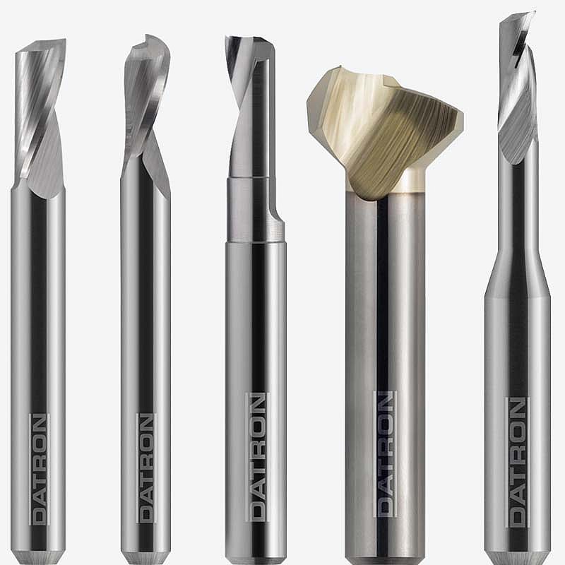

Advantages of a Single Flute Cutter
Fully leveraging the benefits of a high-speed spindle requires the evacuation of the chips from the machining operation. If the chips remain in the cutting channel, it will clog the operation, create poor surface finishes, and reduce your potential feed rate. DATRON developed a unique line of micro-grain carbide cutting tools with a single cutting flute. Due to the spindle’s high rotation speed or RPM, you can have a significantly faster feed rate than 2, 3, or 4 flute cutting tools at lower RPMS. The advantage of grinding a single cutting edge is that you can create a substantial relief or open space behind the sharp cutting edge, allowing room for the chip to evacuate. The single flute cutters come in various diameters, shank sizes, and cut lengths. These tools are not practical in spindles with speed ranges below 15,000 RPM.

Single Flute End Mills
Single Flute End Mills provide superior chip evacuation for high-volume material removal, which allows for higher feed rates and shorter cycle times. These tools are available with various cutting lengths and shank diameters.

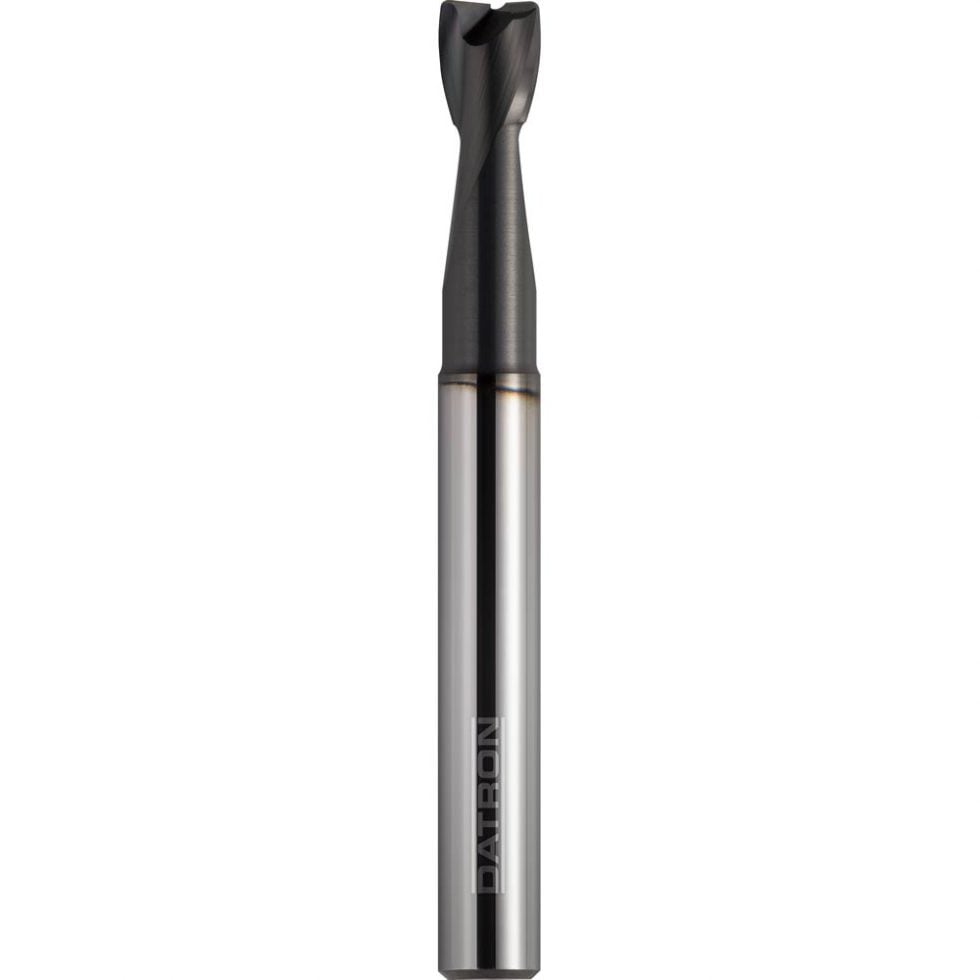

Micro Toothed End Mills
Micro Toothed End Mills are ideal for abrasive materials like composites or engineered plastics. CRP, GRP, or printed circuit board material can be reliably machined at low cost with the micro-toothed end mills from DATRON.

Double Flute End Mills
Whether finishing pockets or making light cuts, a DATRON Double Flute End Mill is the tool to use when surface finish counts. These strong, balanced tools produce minimal vibrations to provide an ultra-smooth finish.
