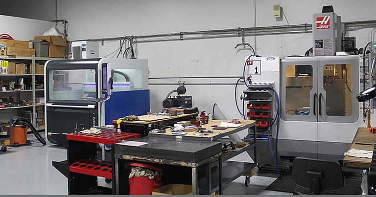

With the DATRON, we’ve actually had fun. It’s been easy to use. Anyone who doesn’t have any sort of machining background is able to go to the machine, pull up a program, and watch a part get made.”
Engineering Team, PQ Controls

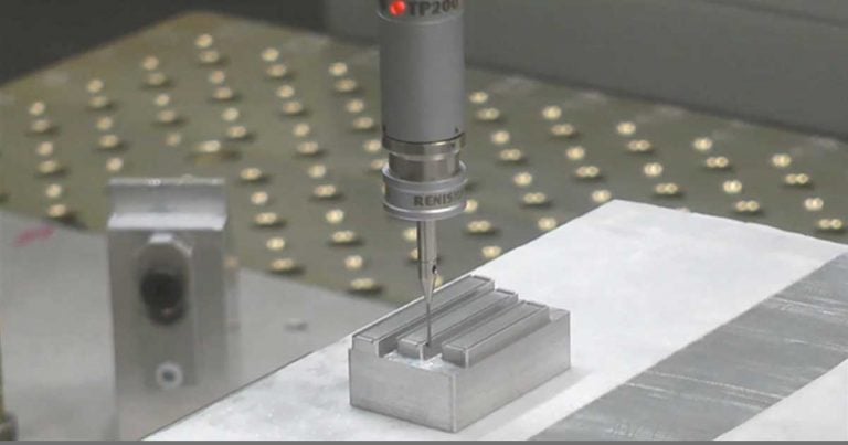

ProbeIntegrated 3D Renishaw Touch probe for precision part finding
