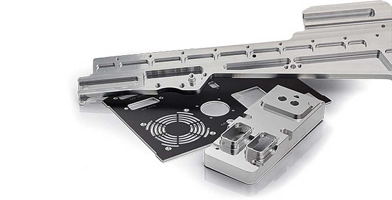

The DATRON MLCube is the best choice for cost-effective large sheet machining with its impressive 60” x 45” machining travel area. It is ideal for projects like front panels, housings, profiles, and other nested aluminum workpieces. The MLCube can also mill non-ferrous metals, plastics, and composite materials. Its short setup times, ability to use different workholding solutions, low power consumption, and excellent price-performance ratio (even for low production volumes) provides long-term and extremely high profitability.
