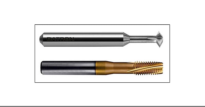

Thread Milling: Advantages and Disadvantages
The primary advantage of thread milling is the ability to control the fit. A threaded hole is milled at a high RPM and the tool helixes into a previously-milled hole. So, the machine operator has the ability to adjust thread size using a strategy similar to using an end mill, rather than a drill bit to make a hole. This can be advantageous if there are tight tolerances on the thread sizes or if allowances need to be made for finishing such as painting.
Also, a single tool can be used in thread milling to make a wide range of hole sizes. This reduces both the cost of tooling and the amount of time associated with tool changes. Plus, a thread mill can create interior and exterior threads, right-hand and left-hand threads, as well as very large threaded holes (e.g. pipe threads). In the case of the latter, this eliminates the need to invest in a large rigid tap to thread big holes.
Furthermore, the thread mill gives the user the ability to design custom threads without having to invest in custom taps which can be very expensive and require long lead times. In the machining of very shallow blind threads in thin materials, the thread mill allows for maximum threads in a very short distance.
The one disadvantage of thread milling is you need to be equipped with a high-speed spindle in order to do it properly, such as the ones found in our line of high-speed milling machines with spindle speeds up 60,000 RPM.
