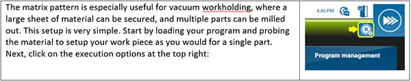

From here, you can activate Multiple Execution, and choose “In Matrix” for layout mode. At this point, simply define the distance between your parts in X and Y, and the number of pieces to create in each direction. From this input, information will be automatically generated on the size of the workpiece and the total number of parts to be milled. At this point, click OK and proceed to run in simulation to verify the correct spacing.

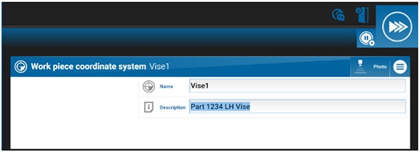

The other method of executing multiple parts is to select With Work Piece Zero Points. This is the best choice when parts are being held in multiple vises, or other fixturing means, where they do not share the same piece of stock. Setting this up is also a piece of cake. First, load the program you want to run, and probe the stock in the first location, and set the zero point. Now, you will need to store this to memory: under Work Piece Setup, go to the Work Piece Management and add a new position to memory:
Then, populate some information about the new position you want to add, and at the bottom, click Save:

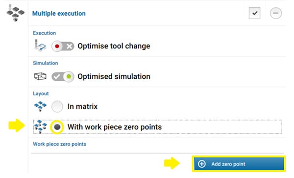

Perform this task for each piece of stock that you want to mill. Once this is done, return to the Execution Options menu. From here, select With Work Piece Zero Points under Layout, then click Add Zero Points.

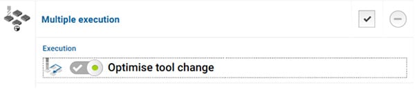

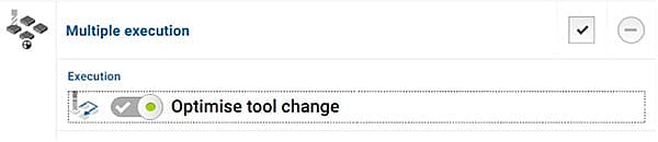

You can even further optimize the process by choosing Optimize Tool Change under Execution Options menu. This will use the tool in the spindle across all parts before changing to the next, thus reducing time spent changing tools.
