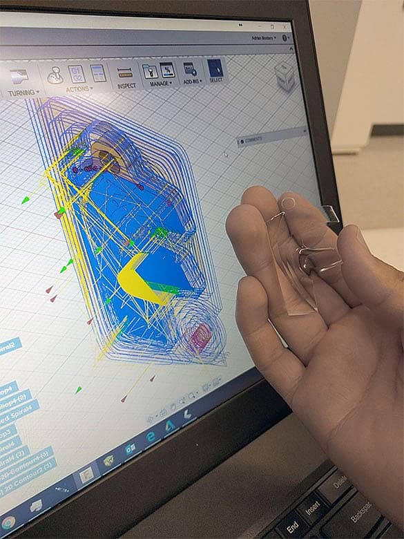

DATRON’s line of carbide end mills include polished and balanced cutters. There are even tools specifically designed for acrylic machining. Combined with a high-speed spindle, the small tooling creates intricate details with ease and leaves burr-free finishes.
If you’re making acrylic parts that require precise details and a smooth surface finish, you need a rigid milling machine instead of a desktop CNC mill. DATRONs are built for precision machining with their rigid construction, high RPM spindles, and micro tooling. The smart control software and touch probe compensate for workholding disparities and any irregularities in your acrylic stock. So your parts stay consistently accurate.
