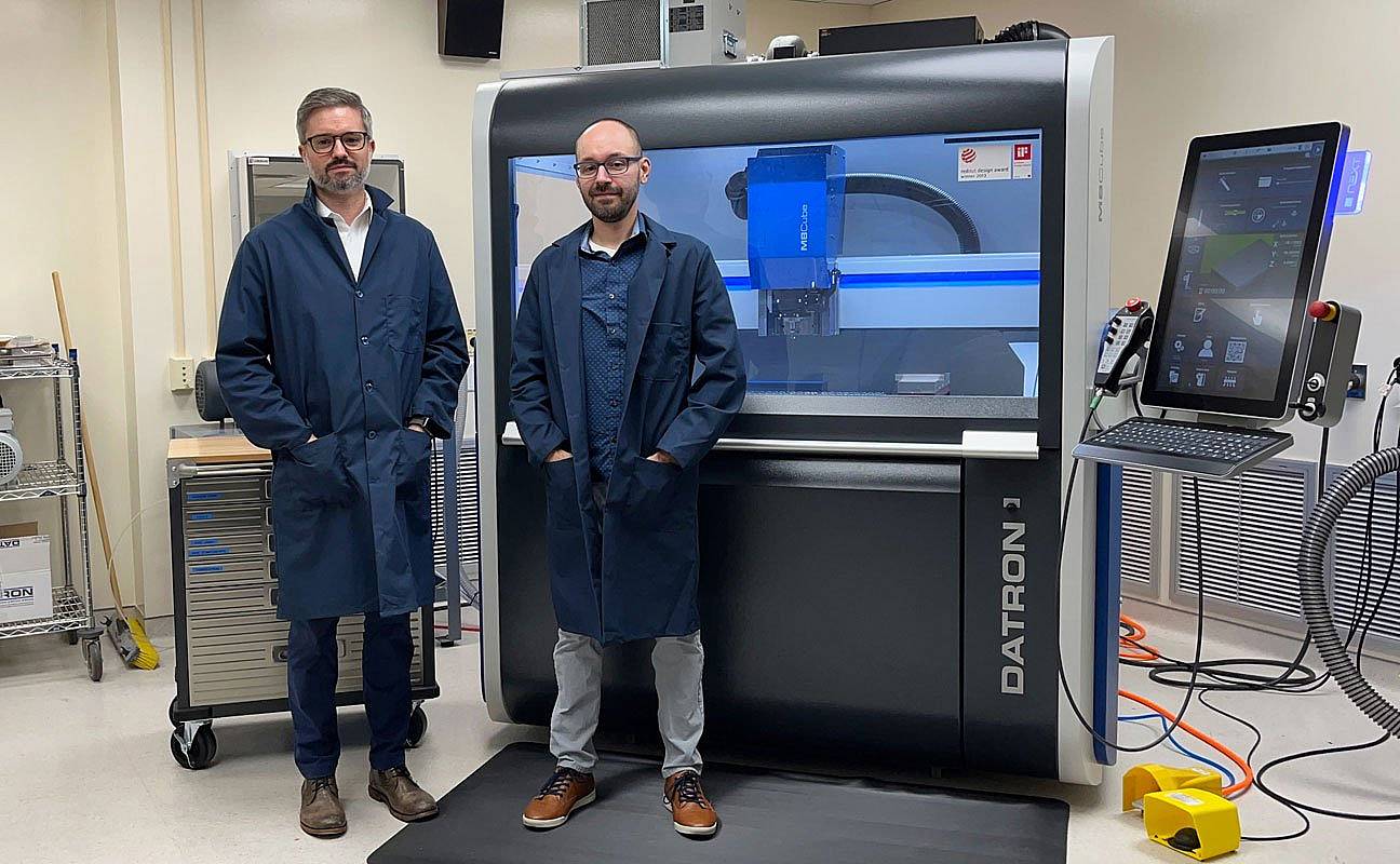

The next step was a visit to one of DATRON’s Technology Centers to evaluate the machine options. David says, “The site visit we did mid-pandemic solidified everything for us. They let us set up parts ourselves and execute the parts we had previously programmed.” Analytical Sales and Services was particularly impressed by the DATRON M8Cube’s small 6’ x 6’ footprint with a 40” x 28” work area. That combination would give them a lot of flexibility for parts and an easier installation in their clean room.
DATRON M8Cube Revs Up the Design Process
After the machine was commissioned and a DATRON Application Engineer trained the team, they began making parts in-house. “The machine’s capabilities have blown me away. Before, I would spend hours trying to figure out how the parts we outsourced would be made on an outside machine. The DATRON M8Cube has alleviated many concerns about design features and tackles the features with ease,” shares Matt.
David notes, “Now, we refine our designs to about 85-90% of what we feel is complete and are not spending large amounts of time on it. Once we have a design, we kick it out on the DATRON CNC machine and assemble it. Our rev cycle now goes from thirty revs to three revs because the part is in our hands, and we can field test it.” They also recognized a lot of their parts were similar in design, so once they had the machining processes dialed in, programming became second nature to them.
The speed and agility of going from a design to a finished part have exceeded their expectations. Matt proudly states, “We have people come around, whether it’s higher-ups in the organization or visitors, and they look at the parts and are just blown away by our capability and what they look like.” David adds, “In terms of aesthetics, we like the optics of the DATRON machine. We have it in an isolated room with a window on it. So, I can say it is a bit of a centerpiece for us.”
