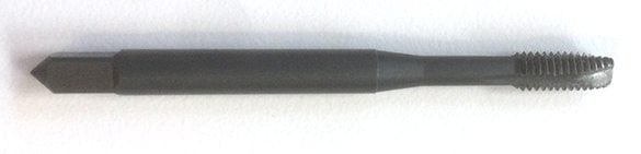

Standard tap for creating threads with a CNC milling machine.
When determining which tap you need you should pay attention to the type of hole you are tapping. When tapping a through hole you can use a standard cut tap which has a lead on it. The lead is the tapered portion on the end of the tap that essentially centers the tap in the hole when engaging.
When tapping a through hole you need to make sure you go deep enough to cut threads all the way through the hole – the length of the lead will depend on the size of the thread. The larger the thread the longer the lead.
