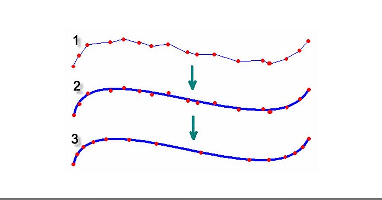

When the machine was first introduced to me in the summer of 2012, Matthias Reck, Director of Research and Development at DATRON AG told me, “We were successful at developing a machine with half as many parts, improved ergonomics, better accuracy, faster rapids and feed rates and that’s structurally stronger than the prior M8 model”. The main reasons for this achievement was changing to a new control system and using direct drive AC brushless motors. Additionally, the gantry was completely redesigned with a stronger Z Axis to secure larger horsepower, high-frequency spindles while providing more stiffness for the higher power drive motors. This achieved greater acceleration and deceleration rates producing faster cycle times. The stronger design along with the new control software allowed them to also develop an optimization filter they call “PerfectCut”. This optional software function creates a powerful look-ahead combined with sophisticated algorithm calculations that can improve three- dimensional contour machining by as much as 30% compared to the previous control software. In some sample parts, cycle times were cut almost in half compared to the already impressive M8 cycle times.
