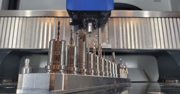

datron-carbide-cutting-tools
Carbide cutting tools, like these DATRON end mills, are ideal for dynamic milling

This strategy does have some requirements, which is why it’s not always an option for machinists. The milling machine needs to be rigid with repeatable feeds and speeds, but it doesn’t necessarily have to be a high-speed CNC machine. However, the machine does need to be capable of high acceleration and deceleration. Dynamic milling programs have lots and lots of code, so the machine control needs the processing capability to read lines quickly and keep up with the commands. The DATRON machine lineup is a good example of machines capable of dynamic milling. In fact, the next© control even has a mode for it.
Your CAM software calculates how to create tool paths to make the desired part, so it needs to be capable of writing a dynamic milling code. The tooling matters, too. The tool’s design, like geometry and coating, should be optimized for material removal.  We suggest using solid carbide tools, like DATRON’s line of carbide CNC cutters. Using higher quality tools means more durability and a longer tool life. So, you aren’t buying and replacing the tools as much.
