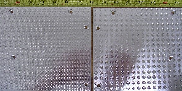

1. How Does a Vacuum Table Work?
The principles on which our vacuum table system works are not that different from others. Your workpiece is mounted atop a rigid aluminum grid pattern and is sucked downward with a vacuum pump, as a result, it is clamped firmly in place. This is especially useful for thin, large sheet material, where traditional clamping methods deliver lackluster results. This is where the similarities end, though.
2. What’s the Thin Sheet Do?
Perhaps the most common and confusing question is what the substrate layer does with our vacuum tables. On nearly every other vacuum chuck design, a gasket needs to be installed into the top of the plate in order to seal against the workpiece – this ensures minimal vacuum loss and strong clamping. The downside of this comes from its inherent limitations – since the gasket is necessary for a strong seal, if the part is cut through, vacuum is lost completely, and the part and tool are destined for the scrap bin.
You don’t need to worry about gasketing off your part, it just has a way of directing the vacuum forces on it’s own… as we’re cutting through this, it’s no problem at all. – John Saunders, Saunders Machine Works
Enter Vacucard – a permeable layer in between the workpiece and the vacuum table that we get so many questions about. As compared to a standard vacuum table, DATRON doesn’t rely on a gasket for a strong vacuum, but the Vacucard layer to slow airflow around the workpiece and disperse the vacuum evenly underneath the part. When paired with a suitable vacuum pump (more on that later) the Vacucard layer allows for vacuum everywhere it’s needed, even when a part is cut through, allowing for maximum flexibility and minimum setup.

4. How Much Clamping Force Does it Provide?
Holding small parts with vacuum is made easy with a DATRON vacuum chuck and Vacucard +++
This is one of my favorite questions to answer because I get to nerd out on the science behind it! The reason vacuum workholding clamps parts so tight isn’t because of the suction underneath, rather, it’s the amount of pressure above. When you pull a hard vacuum underneath your workpiece, the force that is holding it in place is actually atmospheric pressure.
Since there is a massive difference in pressure from under the part (25-29 inHg) versus the top of the part (14.7 psi at sea level) the result is a rigid bite on the vacuum chuck. Figuring out the clamping force on your own is an easy task – simply take the surface area of your material and multiply it by the atmospheric pressure at your altitude.
For example, a 9-inch square piece of material has 81 square inches of surface area, and the atmospheric pressure at sea level is 14.7psi. Therefore, 81in² x 14.7psi = 1,190.7 lbs! Rest assured, over half a ton of clamping pressure is sufficient for holding parts on a DATRON.
