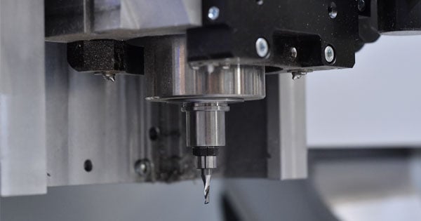

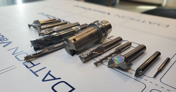

Tip #1 – Invest In Quality Tooling
Save yourself a headache and some money by avoiding cheap cutters that quickly wear out and easily break. High-quality tooling is made to withstand the forces of high-speed machining, providing better quality and consistency in your production. DATRON experts recommend carbide tooling because it’s 3x more rigid than high-speed steel tools. Plus, carbide is known for handling higher SFPM (surface feet per minute) rates, and it maintains a longer tool life. For parts that need an extra superior finish, it’s worth checking out balanced CNC tools. This type of CNC tool is designed to mitigate vibration and reduce chatter marks, so your parts have cleaner cuts and smoother finishes. DATRON carbide cutters are engineered for precision, performance, and extended tool life; you can order them online at our tool store.

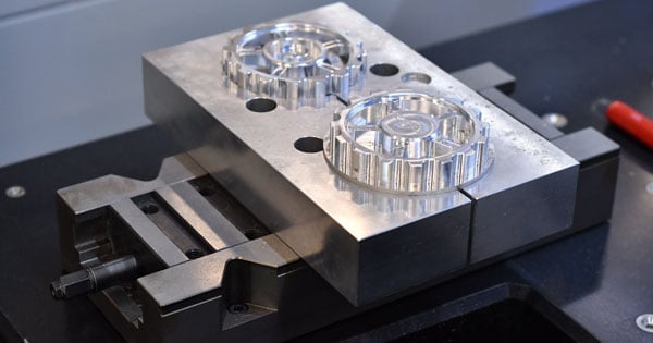

Tip #5 – Outfit Your Machine with Reliable Workholding
We all know it’s important to keep a part in place, but sometimes that’s easier said than done. Especially when dealing with delicate materials and difficult shapes. Good CNC machining means producing repeatable results, which is a challenge when you’re switching between jobs.
Do some research, check out machining forums, and read product reviews to see which workholding will be the best fit for your machine and application. With the proper workholding accessories, your production quality will be greatly improved and your set-up times will be greatly reduced. Fortunately, there are tons of resources available that can help you improve your CNC machining skills. A few of our favorites are: CNC Cookbook, Titans of CNC Academy, Proven Cut, and Autodesk’s Fusion 360 courses.
DATRON offers a variety of module clamping technology (even for odd shapes and soft materials) that provide precise positioning, fast set-up times, and make it easy to switch between jobs. If you’re interested in learning more CNC machining tips from the DATRON’ team, check out more CNC machining blog posts.
