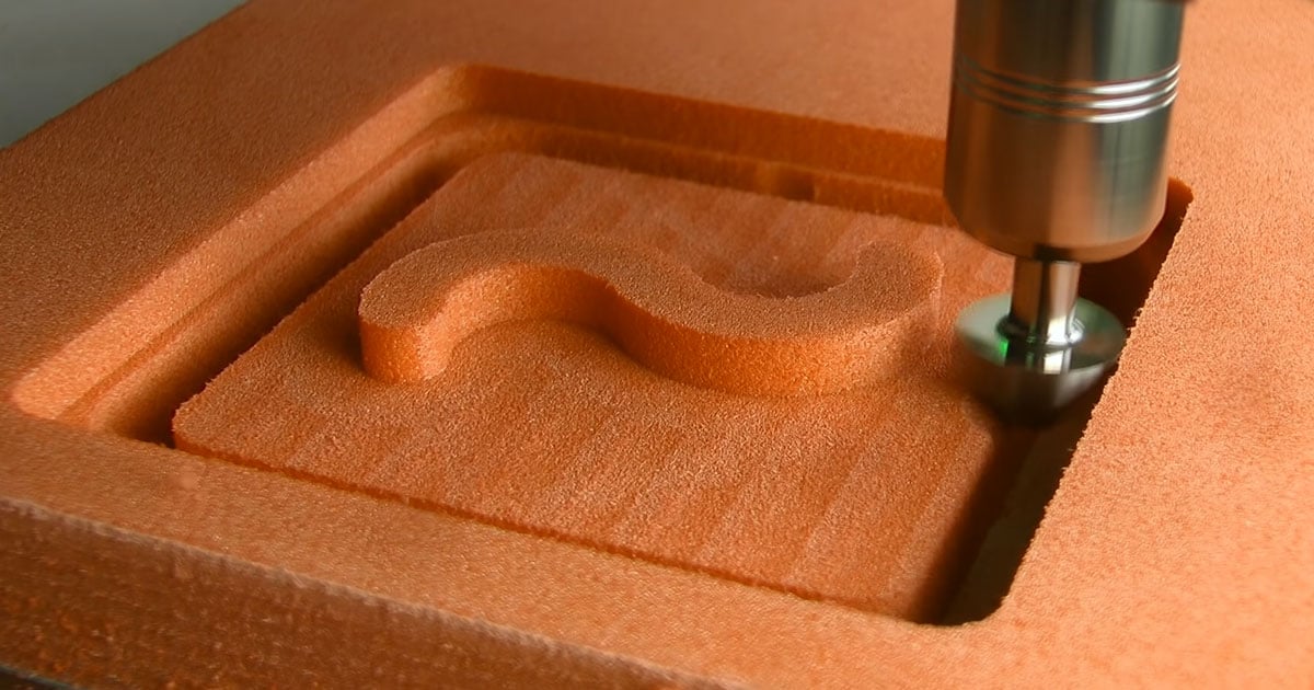

Our application engineer team used conventional milling and climb milling with DATRON’s foam end mills to create tool kits for our service technicians.

Another instance of when to use conventional milling is for a finish pass with foam. Instead of tearing the material when you cut down with a climb milling strategy, you’re pushing the material into itself with up milling. To get even smoother cuts and edges with your foam parts, our customers use DATRON’s foam cutters.
Grimsmo Knives used DATRON’s foam end mill (product #00680530) and conventional milling to perfect their foam packaging process.
