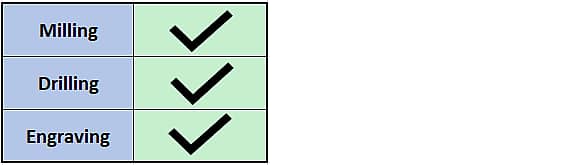

Consistent Depth of Cut Method 1: Qualify the Surface
If you are able to do so, qualifying the surface is far and away the easiest and most sure-fire way to make sure that the surface you’re about to work on is reasonably flat and true. Qualifying a surface is just fancy machinist talk for face milling the entire surface, taking off a few thousandths at a time until the whole surface is reasonably uniform in terms of flatness. A qualification pass is often the first step you will see when watching a milling process on a shop floor or online and this is for a number of reasons, not least of which is to ensure flatness of the surface in question.
When starting with a piece of billet or raw stock, qualifying a surface is almost always an option and in general is just good machinist practice. Sometimes, however, qualifying the surface simply is not an option – such as when working with die cast material, a forging, or with otherwise completed parts that simply need marking or serialization. In these cases, a different strategy will need to be employed in order to achieve a good result.

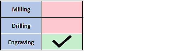

Consistent Depth of Cut Method 2: Use of a Spring-Loaded Engraving Tool
If all you need to do is a basic engraving or part marking process, and your surface is a little “all over the map” a spring-loaded engraving tool may be just what the doctor ordered. Spring-loaded tools come in a few different varieties, with the most popular versions being a spring-loaded version of a traditional split shank engraving tool and a spring loaded “drag engraving bit”, also known as a “scribe” tool.
Spring Loaded Engraving Tool: This tool can help keep you in the ballpark on basic engraving jobs.
Photo Credit: 2L Inc. – http://www.2linc.com/engraving.htm
Spring-loaded engraving tools incorporate a compressible mechanical system between the spindle interface and the cutting tool. These tool assemblies usually have anywhere from 0.20” to 0.40” of spring travel, so they can absorb a fairly dramatic change in Z height while still keeping a consistent downward pressure on the workpiece. Spring loaded engraving bits utilize a tipped split shank engraving tool and as such can produce a variety of engraving widths and depths. Drag engraving or scribe tools literally only are dragged across a surface and are not designed to incorporate a rotational element into the process. As a result, scribe tools a truly only a good fit for very shallow part marking.
While these tools will not be of much assistance when it comes to milling or drilling applications, they perform very well for shallow to moderate depth part marking. However, there are some drawbacks to this type of tool: a common shank size for these tools is ¾”, which may be too large for some spindles. Also, since these tools are a mechanical assembly they are usually limited to 10,000 RPM max. This limitation may force you to slow your feed rate down, increasing your cycle time.
So, if you need to tool up to serialize a thousand cast aluminum parts, a spring-loaded tool will likely get the job done. However, if you are planning on completing a milling or drilling process, or if the job requires a deep, wide, or intricate/high-quality engraving, you may need to turn to other methods to get the job done.
Consistent Depth of Cut Method 3: Use of a Touch Probing System to Map an Irregular Surface
Surface mapping via touch probing usually involves giving the machine several basic details about what you wish to probe: size of the probe area, pitch of the probing grid, and so on. From there the machine will touch off on the workpiece as many times as is necessary to probe the specified area to the desired grid pitch. Once the touch probing cycle is complete, the machine control will take the cut file that has been programmed to be cut on a flat 2D surface and modify it with the variation in Z of the workpiece that was found during the probing cycle. This way, when the cutter goes about the process of milling or engraving on the surface, it’s depth will vary automatically so you get a consistent depth of cut regardless of variation in the Z height of the surface.

Not all CNC machines offer touch probing, and surface mapping isn’t always an option when they do. But if your machine has probing and surface mapping it’s not a bad idea to get familiar with it – you never know when it might come in handy.
