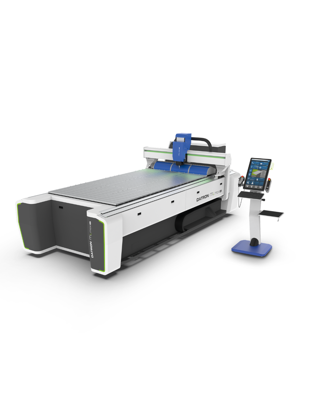

The DATRON MLmax Pro is DATRON’s largest CNC milling machine, engineered for high-speed, high-precision machining of large-format sheets and parts. Its rigid machine design and dynamic performance deliver dependable accuracy- evem across demanding, large scale applications. With its expansive machining area, the MLmax Pro is ideal for machining large or bulky components while also supporting efficient production of smaller parts. Built for flexibility, productivity, and performance, It is a powerful solution for modern manufacturing environments.
Dynamic, Precise, and Intuitive Machining
The DATRON MLmax Pro features a mass-optimized design that supports highly dynamic axis movement while maintaining exceptional rigidity throughout the machine structure. Its low-friction drive concept with a driven nut enables travel speeds of up to 60 m/min, supporting fast, accurate machining.
• Precision Across the Entire Work Area: The steel table frame is reinforced with a 35 mm thick, low vibration UHPC cast base to provide a stable, rigid foundation for precise machining.
• DATRON next: Intuitive Control: The intuitive touchscreen interface guides users through the machining process step by step, helping operators of all experience levels get started quickly and confidently.
• Plug-and-Play Compatibility with DATRON Accessories: The proven conical mounting system enables repeatable installation of DATRON clamping devices. Up to 18 vacuum fields can be controlled individually.
• Minimum Quantity Lubrication (MQL): Two compact, seamlessly integrated coolant tanks-each with a 10 L capacity-help conserve valuable floor space.
DATRON MLmax Pro Specifications
NameDetail
Travel1,570 mm x 3,160 mm x 245 mm
Machining Envelope1,500 mm x 3,000 mm x 200 mm (Z = gantry clearance)
Spindle1.8 kW–4.0 kW HF spindle; up to 48,000 rpm; HSK-E25
Tool Management12-position with HSK-E25 tool holder
(optional 36-position)Tool length touch probe (optional)
Machine TableSteel table; integrated conical threads
Base FrameMass-optimized steel frame with UHPC casting
Control/SoftwareDATRON next
Operating TerminalFree-standing terminal with 24“ multi-touch display with additional
manual operating panel and 24“ display on the machine (optional)
Workpiece Measurement3D touch probe (optional)
Axis ExtensionDATRON Axis4 (optional)
Feedup to 50 m/min
Rapid Traverseup to 50 m/min
Installation dimensions without operating terminal (W x D x H)2,100 mm x 4,700 mm x max. 1,870 mm
Operating terminal installation dimensions (W x D x H)800 mm x 710 mm x 1,500–1,700 mm; flexible installation site
Weightapprox. 8,000 kg
