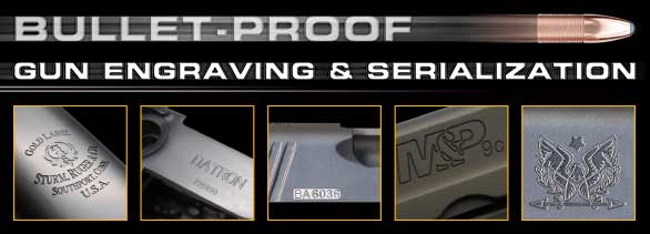

Samples of Gun Engraving with a CNC Milling Machine:
For most gun owners, the purchase of a gun is a decision that deserves some research and scrutiny with regards to quality and performance. Knowing this, gun manufacturers invest incredible amounts of money promoting their brand. The word “brand” is derived from the branding or marking on the product itself. So, it’s only logical that gun manufacturers want their logo or “brand” to appear in its best form on the gun to in order convey quality. In other words, aesthetics count. The samples below, show the crisp clean quality of gun logos engraved with a high speed CNC milling machine featuring a 40,000 – 60,000 RPM spindle.
Gun brands or logos, including the Ruger logo (left) on a curved shotgun receiver, are engraved at an even depth.
As mentioned throughout this blog, the depth of gun serial numbers is regulated by the ATF, and therefore, the quality of serial number marking is not as much about aesthetics as it is about satisfying government mandates. High speed CNC milling machines provide the greatest accuracy and depth of engraving as illustrated by the samples below.
Gun serial numbers engraved on a high speed CNC milling machine.
Since the ATF is consistent in their specification for an engraving depth of 0.003” on other gun markings like the place of origin (manufacturer location), caliber, gauge and model number, logically, gun manufacturers want to consolidate all engraving into a single process to save time and money. The Smith & Wesson M&P handgun slides below were engraved on a DATRON high speed milling machine equipped with a rotary indexer used to flip the part so that both sides could be engraved in a single set up. This automation eliminates operator intervention associated with manual setup for engraving on each side of the gun.
ll markings on these M&P slides were engraved a 0.005″ with a high speed milling machine.
